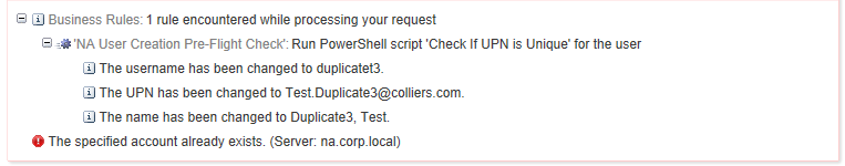

I am still seeing an error when creating a second user in the same OU. I am doing a check before the user is created and my guess is that its not changing the DN. How can I catch a more detailed error from the script?
What is the error that you get? Can you post a screenshot of it here?
Also, how do you create the users? Do you create them in the Administration Console, in the Web Interface or do you import them somehow?
We are creating the users through the web interface. With a pre-flight script in this post.
We've updated the script with a check for duplicate usernames (SAMAccountNames). Replace the script that you have with the one posted here and try creating the same user. Then, post a screenshot of the Execution Log here.

    $searcher.SearchParameters.Filter = "(&(objectCategory=user)(userPrincipalName=$userLogonName))"
    $searcher.VirtualRoot = $True
    $result = $searcher.ExecuteSearch()
    $users = $result.FetchAll()
    $result.Dispose()
    if ($users.Count -eq 0)
        return $True
    return $False
function IsPropertyNameUnique($objectName, $domainName)
    $user = Get-AdmUser -Filter {name -eq $objectName} -erroraction silentlycontinue -AdaxesService "localhost" -Server $domainName
    return $user -eq $Null
function IsUserNameUnique($username, $domainName)
   $user = Get-AdmUser $username -erroraction silentlycontinue -AdaxesService localhost -Server $domainName
# Get the user name info
$username = $Context.GetModifiedPropertyValue("samAccountName")
$userLogonName = $Context.GetModifiedPropertyValue("userPrincipalName")
$sn = $Context.GetModifiedPropertyValue("sn")
$givenName = $Context.GetModifiedPropertyValue("givenName")
# Check if the username is unique
if (!(IsUPNUnique $userLogonName))
    # Add Initials and check for uniqueness
    $initals = $Context.GetModifiedPropertyValue("initials")
    if ($initals -ne $NULL)
        $uniqueUserLogonName = "$sn.$initals.$givenName@$upnSuffix"
        $uniqueUsername = "$sn.$initals.$givenName"
    # If the username is not unique, generate a unique one
    for ($i = 2; $True; $i++)
        if (IsUPNUnique $uniqueUserLogonName)
            break
        $uniqueUsername = $username + $i
        # Build new UPN
        $uniqueUserLogonName = "$sn.$givenName$i@$upnSuffix"
    # Check sAMAccountName
    if (!(IsUserNameUnique $uniqueUsername $domainName))
        $Context.Cancel("The username (SAMAccountName property) is not unique.")
    # Update User Logon Name (pre-Windows 2000)
    $Context.SetModifiedPropertyValue("samAccountName", $uniqueUsername)
    $Context.LogMessage("The username has been changed to " + $uniqueUsername `
      + ".", "Information")
    $Context.SetModifiedPropertyValue("userPrincipalName", $uniqueUserLogonName)
    $Context.LogMessage("The UPN has been changed to " + $uniqueUserLogonName `
# Get the object DN
$objectDN = $Context.TargetObject.ObjectInfo.DN;
$objectLeaf = $objectDN.Leaf
if (!(IsPropertyNameUnique $objectLeaf.Value $domainName))
    for ($i = 1; $True; $i++)
        $objectName = $objectLeaf.Value + $i
        if (IsPropertyNameUnique $objectName $domainName)
            break
    # Rename the object
    $Context.SetModifiedPropertyValue("name", $objectName)
    $Context.LogMessage("The name has been changed to " + $objectName `
