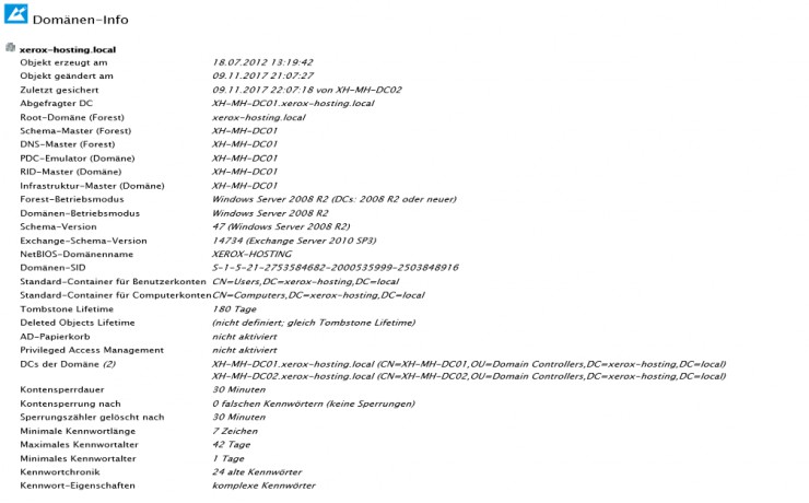

I try to build a report for all relevant properties of a domain like
image.png Schema Version: Get-ADObject (Get-ADRootDSE).schemaNamingContext -Property objectVersion
Exchange Schema Version: Get-ADObject -filter * -SearchBase ((Get-ADRootDSE).schemaNamingContext) -Properties * | Where-Object {$_.Name -eq "ms-Exch-Schema-Version-Pt"} https://eightwone.com/references/schema-versions/
I have also problems to build the statistic part from the report.
regards Helmut

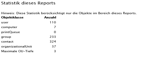

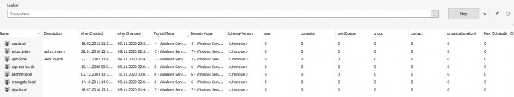

Hello
the statistic part is the count of the different object types like users, computers ...
image.png PS C:\Users\s-ADSsvc0001> Get-ADObject (Get-ADRootDSE).schemaNamingContext -Property objectVersion
DistinguishedName : CN=Schema,CN=Configuration,DC=int,DC=sds-bs,DC=de Name              : Schema ObjectClass       : dMD ObjectGUID        : 782ed326-0708-4563-a6f4-dd458ea9416a objectVersion     : 88
PS C:\WINDOWS\system32> Get-ADObject -filter * -SearchBase ((Get-ADRootDSE).schemaNamingContext) -Properties * | Where-Object {$_.Name -eq "ms-Exch-Schema-Version-Pt"}
adminDescription                : ms-Exch-Schema-Version-Pt adminDisplayName                : ms-Exch-Schema-Version-Pt attributeID                     : 1.2.840.113556.1.4.7000.102.97 attributeSyntax                 : 2.5.5.9 CanonicalName                   : xerox-hosting.local/Configuration/Schema/ms-Exch-Schema-Version-Pt CN                              : ms-Exch-Schema-Version-Pt Created                         : 31.07.2012 17:38:58 createTimeStamp                 : 31.07.2012 17:38:58 Deleted                         : Description                     : DisplayName                     : DistinguishedName               : CN=ms-Exch-Schema-Version-Pt,CN=Schema,CN=Configuration,DC=xerox-hosting,DC=local dSCorePropagationData           : {01.01.1601 01:00:00} instanceType                    : 4 isDeleted                       : isMemberOfPartialAttributeSet   : False isSingleValued                  : True LastKnownParent                 : lDAPDisplayName                 : msExchSchemaVersionPt Modified                        : 22.01.2020 13:54:51 modifyTimeStamp                 : 22.01.2020 13:54:51 msDS-IntId                      : -2075693490 Name                            : ms-Exch-Schema-Version-Pt nTSecurityDescriptor            : System.DirectoryServices.ActiveDirectorySecurity ObjectCategory                  : CN=Attribute-Schema,CN=Schema,CN=Configuration,DC=xerox-hosting,DC=local ObjectClass                     : attributeSchema ObjectGUID                      : 54349ed6-2c08-4f7e-b0f2-e6c3847c0d4c oMSyntax                        : 2 ProtectedFromAccidentalDeletion : False rangeLower                      : 1 rangeUpper                      : 15332 schemaIDGUID                    : {213, 152, 129, 95...} sDRightsEffective               : 11 searchFlags                     : 0 showInAdvancedViewOnly          : True uSNChanged                      : 8929 uSNCreated                      : 8929 whenChanged                     : 22.01.2020 13:54:51 whenCreated                     : 31.07.2012 17:38:58
For Schema Version (objectVersion) and Exchange Schema Version (rangeUpper) it would be format number and values 88 and 15332.
regards Helmut

by (510 points)
printQueue = (Get-ADObject -LDAPFilter '(ObjectClass=PrintQueue)' ).count maxOU = (Get-ADOrganizationalUnit -Filter -Properties | select CanonicalName | %{ ($_ -split '/').count - 1 } | measure -Maximum).Maximum
In PS I would use (Get-ADDomain).DomainMode and (Get-ADForest).ForestMode to get information.
regards Helmut

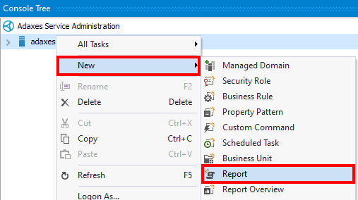

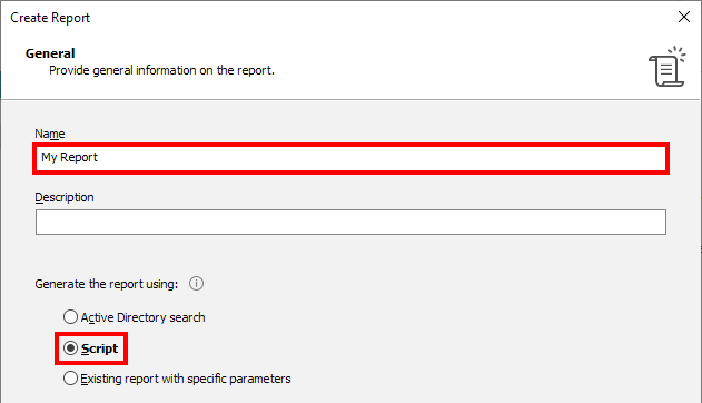

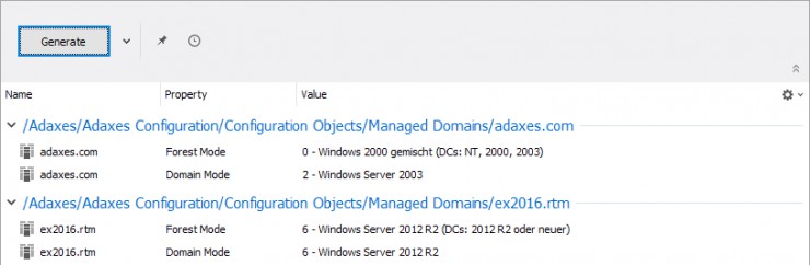

Thank you for the clarification. To create the report:
  4. Specify a report name and select Script in the Generate the report using section. image.png
  5. Click Next three times.

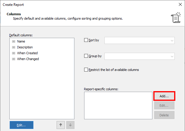

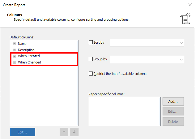

  6. Add the When Created and When Changed columns to the Default columns list. image.png

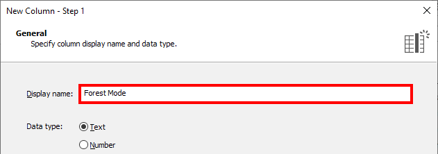

  9. Click Next.

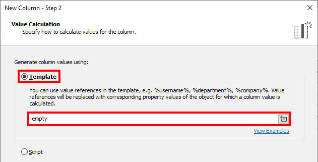

  10. Select Template.
  11. In the field below, enter a default value (e.g. empty). The value will never be present in the report and is only required to create the custom column. image.png
  12. Click Finish.

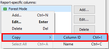

      1. Click Back.
      2. In the Report-specific columns section, right click the custom column.
      3. In the context menu, navigate to Copy and click Column ID. image.png The identifier will be copied to clipboard.
    • $domainModeColumnID – Specifies the identifier of the custom column that will display the domain mode.
