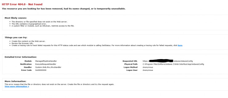

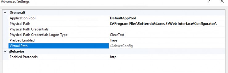

After updating from 2020.1 to 2021.1, my IIS keeps throwing a 404 not found error when attempting to access the Web interface configurator. I'm thinking that the path could be wrong or something could be missing?
Does the issue occur only for Adaxes Web interface or for the Web interface configurator too? Could you, please, post here or send us (support@adaxes.com) the URLs you are using?
Hello, after upgrading to Adaxes 2023 we lost connection to Web Interface Configurator. Adaxes and Adaxes Web Interface are ok and users are able to login. URL http: ... went ok except I had to start manually Softerrra Adaxes service after restoring settings.
