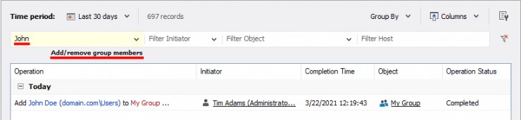

To view the log records about a user membership updates, you can filter the logs by the user name. The filters should be like the following: image.png

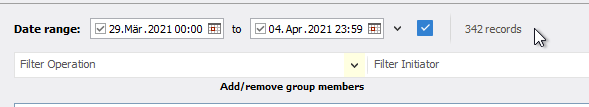

  5. Specify the required range. The number of records will be displayed next to the drop-down. image.png

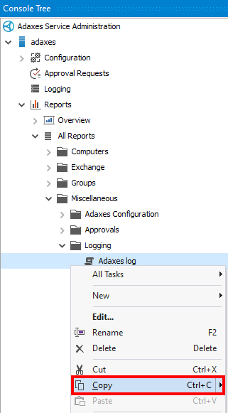

  5. In the context menu, click Copy. The report will be copied to clipboard. image.png

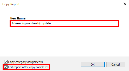

  7. Specify a new name for the report (e.g. Adaxes log membership update).
  9. Click OK.

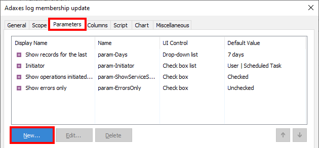

  10. Activate the Parameters tab.

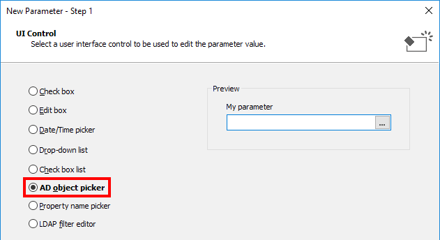

  13. Click Next.

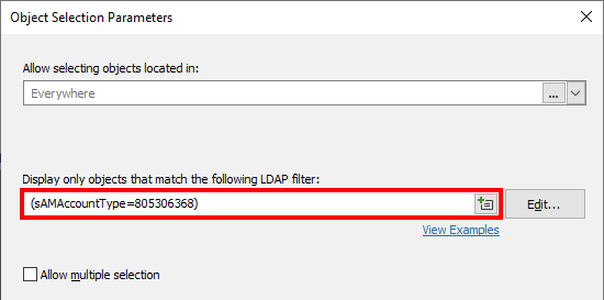

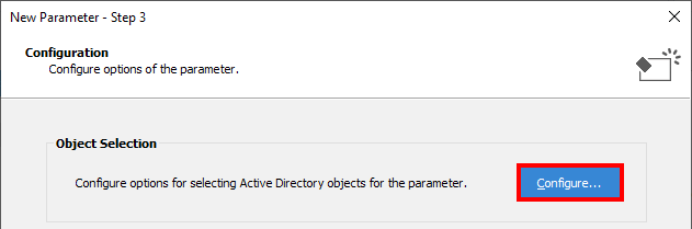

  17. In the Display only objects that match the following LDAP filter field, specify the following filter: (sAMAccountType=805306368) image.png
  18. Click OK.

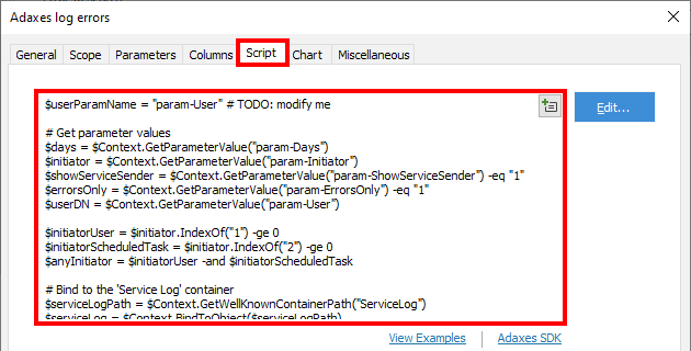

  20. Activate the Script tab.
  21. Replace the script in the tab with the script below. In the script, the $userParamName variable specifies the name of the parameter created on step 14 with the param- prefix (e.g. param-User).
$userParamName = "param-User" # TODO: modify me
# Get parameter values
$days = $Context.GetParameterValue("param-Days")
$initiator = $Context.GetParameterValue("param-Initiator")
$showServiceSender = $Context.GetParameterValue("param-ShowServiceSender") -eq "1"
$errorsOnly = $Context.GetParameterValue("param-ErrorsOnly") -eq "1"
$initiatorUser = $initiator.IndexOf("1") -ge 0
$initiatorScheduledTask = $initiator.IndexOf("2") -ge 0
$anyInitiator = $initiatorUser -and $initiatorScheduledTask
# Bind to the 'Service Log' container
$serviceLogPath = $Context.GetWellKnownContainerPath("ServiceLog")
$serviceLog = $Context.BindToObject($serviceLogPath)
# Get log records
$generalLog = $serviceLog.GeneralLog
$generalLog.StartDateTime = (Get-Date).AddDays(- $days)
$generalLog.EndDateTime = Get-Date
$log = $generalLog.Log
$records = $log.GetPage(0)
foreach ($record in $records)
    if ($Context.Items.Aborted)
    if ($errorsOnly -and -not(
        ($record.State -eq "OPERATION_STATE_FAILED_CAN_CONTINUE") -or
        ($record.State -eq "OPERATION_STATE_FAILED_NO_CONTINUE")))
    if ($record.TargetObjectType -ne "group")
    # Filter by the member added/removed
    $userDn = New-Object "Softerra.Adaxes.Ldap.DN" $Context.GetParameterValue("param-User")
    $userName = $userDn.Leaf.Value
    if ($record.Description -notlike "*$userName*")
    $operationTypes = $record.GetOperationTypes()
    if ($operationTypes -notcontains "manage group members")
    if (-not $anyInitiator)
        $initiatorClass = $record.Initiator.ObjectClass
        if ((($initiatorUser -eq $False) -and $initiatorClass -ieq "user") -or
            (($initiatorScheduledTask -eq $False) -and
                (($initiatorClass -ieq "adm-ScheduledTask") -or
                ($initiatorClass -ieq "adm-ReportScheduledTask"))))
    if (-not $showServiceSender)
        if ($record.CommandSender -ieq "Service")
    $Context.Items.Add($record)
image.png 22. Click OK.
