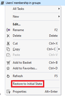

I recently updated to Adaxes 2023.2 from 2021.x. We have a weekly email that goes out documenting users membership in groups and it is helpful for a historical look at when someone was added to or removed from a group and also to refer back to the access a prior employee had.
We were using the 'Users membership in groups' report which uses the sub-report 'Objects membership in groups'. When I took a look, the subreport 'objects membership...' is disabled. If I enable it, there is still an issue.
I get these errors: The property 'Filter' cannot be found on this object. Verify that the property exists and can be set. Stack trace: at , : line 22 Exception calling "GetPropertyByName" with "1" argument(s): "The search result entry doesn't contain the property 'primaryGroupToken'." Stack trace: at , : line 34
by (450 points)

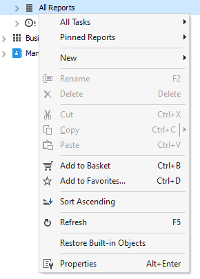

The behavior is expected when you upgrade from Adaxes 2021.1 or older to the latest version. To remedy the issue, you need to restore built-in reports to initial state. image.png It is recommended to do that for all the built-in reports. image.png
by (450 points)
Thanks for the quick response; this was the issue. I've reset all reports and this one is working for me again.
