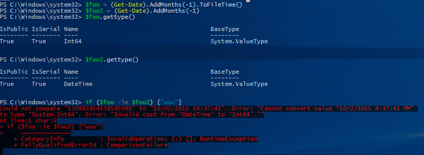

It looks like the get-date cmdlet stores the date as an Int64 not DateTime when using "ToFileTime". Aside from that, I'm not sure if using "[datetime]terminationDate" in the filter would actually work to convert the string to datetime. You could filter on anybody that has a terminationdate attribute populated and then do the date comparison after the fact, which I realize isn't as efficient, but still an alternative.

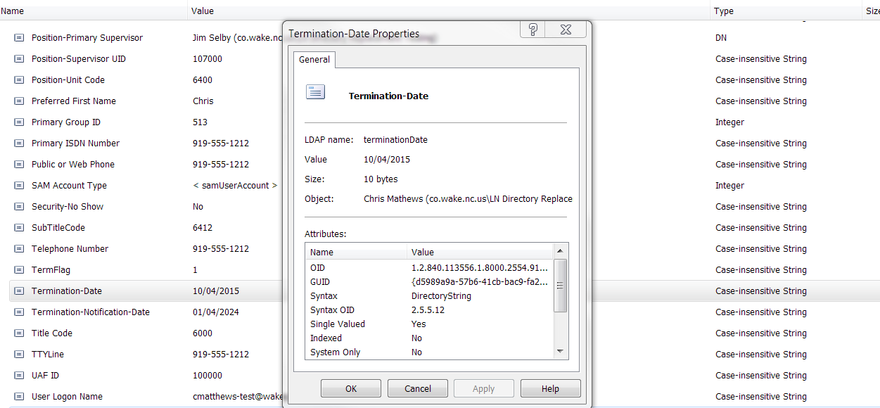

Can you provide the format in which dates are stored in the terminationDate attribute so we could provide you a script? Just a couple of examples of the dates stored in the attribute will be enough.
Screen capture attached.
(Active Directory Snippet with TerminationDate)
Here's a code snippet that will do the job:
