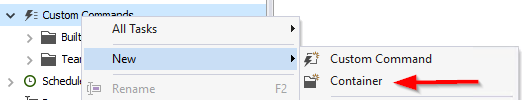

Thanks for the info. I'm not sure I was clear in my original question though, the containers I'm referrring to are the new containers under the Custom Commands. When I create these I have an option to speficy a custom attribute. AdaxesContainer.png While looking at the properties later I don't see a way to update this attribute. I'm also not sure how to reference this attribute from powershell.

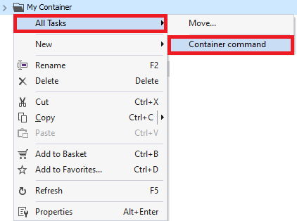

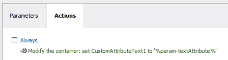

Thank you for clarifying. To update properties of a container created in one of the containers for Adaxes configuration objects (e.g. in the Custom Commands container) you can use a custom command configured for the Container object type. Property values can be specified using the command parameters. For example, such a custom command can look like the following: image.png To execute a command, right-click the container, navigate to All Tasks and then click the command you need. image.png Values of such container properties can only be viewed using a PowerShell script. For example, it can be done by outputting values into the execution log via a script like below. In the script, the $propertyName varialbe specifies the LDAP name of the property.
