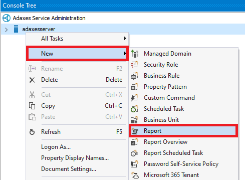

Thank you for the confirmation. Use the following script from our repository to populate the parameter with Microsoft 365 licenses: https://www.adaxes.com/script-repository/update-report-drop-down-parameter-with-microsoft-365-licenses-s622.htm. To create the report:

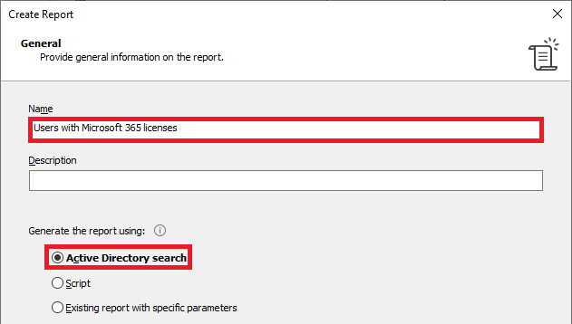

  4. Specify a report name.
  6. Click New.

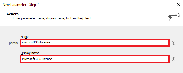

  11. Specify a parameter name and display name (e.g. microsoft365License and Microsoft 365 License). image.png
  12. Click Next.

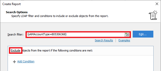

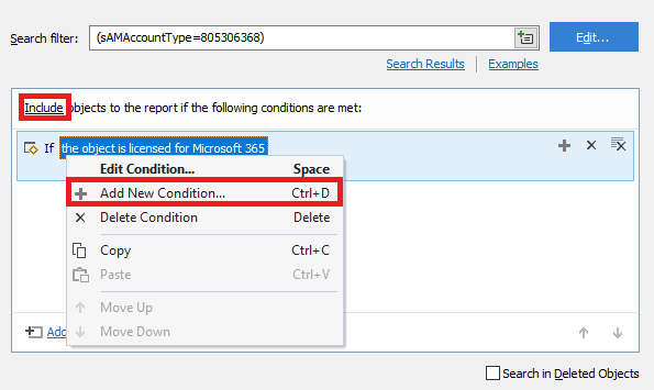

  17. In the Search filter field, enter the following: (sAMAccountType=805306368)

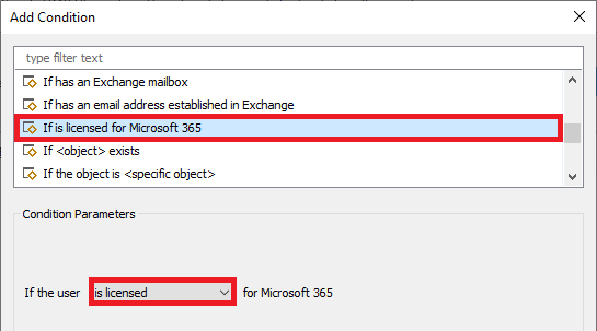

  19. Click Add Condition.

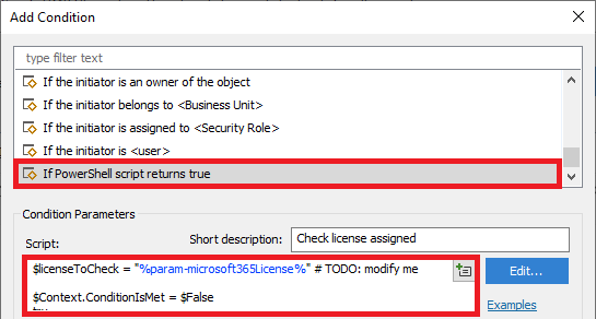

  21. Right-click the condition you created and then click Add New Condition. image.png
  22. Select If PowerShell script returns true.
  23. Paste the below script into the script field. In the script, the $licenseToCheck variable should be set to a value reference of the parameter created on steps 9-15.
$licenseToCheck = "%param-microsoft365License%" # TODO: modify me
    # Get Microsoft 365 account properties
    $microsoft365Properties = $Context.TargetObject.GetOffice365Properties()
    return # No Microsoft 365 account
# Get assigned licenses
$licenses = $microsoft365Properties.Licenses
foreach ($license in $licenses)
    if (($license.Assigned) -and ($license.Sku.SkuPartNumber -eq $licenseToCheck))
