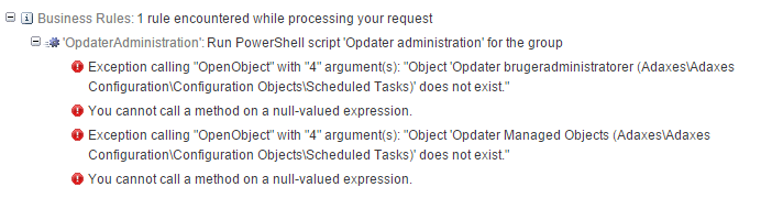

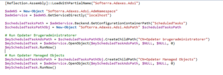

After adding or removing users (from WebUI) from certaing sec. groups, I let a Business Rule execute two Scheduled Tasks,
as shown in this http://www.adaxes.com/sdk/?ApiDocumenta ... struction.
The BR responds correctly, but I get this error:
The Script:
Adding og removing a user via the Adaxes Administration Console throws the same error.

Most probably, the errors occur because you've placed your Scheduled Tasks in a certain sub-container within the Scheduled Tasks container. The sample script you've mentioned assumes that the Scheduled Task you want to run is located directly under the Scheduled Tasks container. If you've created the tasks in a certain sub-container, then you need a slightly different code.

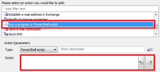

To create a Custom Command that runs one of the scripts you need:
  2. If you don't want the Custom Command to be available in the UI, you need to disable it. Disabled Custom Commands cannot be executed on AD objects manually, but can be run using Business Rules, Custom Commands and Scheduled Tasks. To disable the command, on step 1 of the Create Custom Command wizard, remove the Enabled option.
  3. On step 2, select the User object type.
  4. On step 3, add the Run a program or PowerShell script action and paste the script that you Custom Command needs to run.
  5. Modify the parameters of the script, if necessary, enter a short description for the script and click OK.
  6. Click Next, then click Finish.
