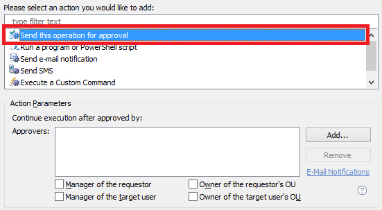

II. Create a Business Rule that will sent the operation for approval
To create a Business Rule that will sent a new user for approval if the virtual attribute is set to True:
  2. On step 2 of the Create Business Rule wizard, select User and Before Creating a User.
  3. On step 3, add the Send this operation for approval action.
  4. Specify possible approvers and click OK.

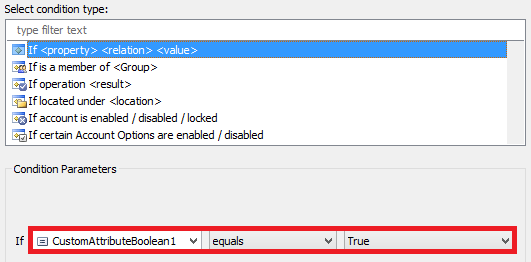

  5. Double-click Always.
  6. Select If <property> <relation> <value>.
  7. Specify If CustomAttributeBoolean1 equals true
    where CustomAttributeBoolean1 is the name of the virtual attribute that you used in the script.
  8. Click OK and finish creation of the Business Rule.
