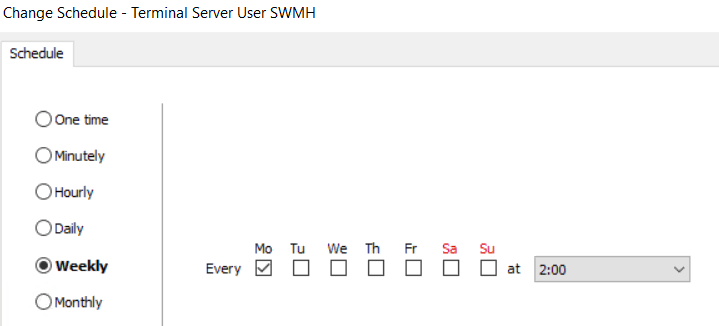

from the GUI, scheduling is only possible on complete hours. How can I change start time to 02:05?
regards Helmut

by (16.9k points)
Hello Helmut,
Unfortunately, there is no possibility to specify minutes when defining a schedule for a scheduled task in the Adaxes Administration console. However, it is possible to use a PowerShell script to define the schedule with precision up to seconds. For details and script examples, please, have a look at the Defining the schedule section of the following SDK article: http://adaxes.com/sdk/ManagingScheduledTasks/#defining-the-schedule.
