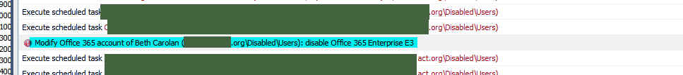

We've ran into a few issues recently where we ran out of Office Licenses without our knowledge and when that happens it causes a lot of our automation around this process to fail....big mess.
I'm looking for a way to generate an email to a few individuals if this happens in the future? I couldn't find where this has been discussed previously so I'm starting a new thread. I could see using this for other tasks of ours also, so is that something we can easily configure on our scheduled tasks?

Just to put a little more context behind this request....for a particular task, when we receive the Red Explanation Mark (see attachment), can we get alerted. Thanks!
