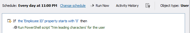

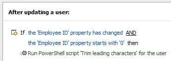

Yes, it should be done using a PowerShell script. To handle the cases when the property is updated in Adaxes, you need to use a business rule triggering After updating a user. However, if the changes are made outside of Adaxes, the rule will not trigger. To make sure that such cases are also handled and all current property values are trimmed accordingly, use a scheduled task. Both the business rule and the scheduled task will use the below script. In the script:
  • $propertyName - Specifies the LDAP name of the property to update.
  • $characterToTrim - Specifies the character that should be trimmed from the beginning of the property value.
  • $pipelined - Specifies whether the update will be passed through Adaxes pipeline. If set to True, corresponding business rules will trigger, log records will be created, etc.

Finally, you should have something like the following:

It looks like it runs OK when I pick a specific user account under scheduled task. But if I try to make it run against an OU (lots of users) it gives this error.
The error occurs because the property specified in the $propertyName variable of the script is empty. You need to make sure that conditions of the scheduled task are configured so that users with empty property value are not affected. For example, you can make it using the condition we provided in the screenshot.
Thanks. Adding the condition to scheduled tasks fixed the error.
Thank you for the confirmation. The condition will also make sure that the scheduled task skips users that already have the property value not starting with zero.
