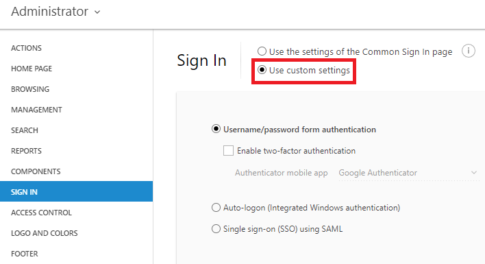

It looks like you have all Web interfaces using sign in settings of the Common Sign In page. It means that when you change settings for the page (e.g. enable MFA) the same applies to all Web interfaces. As a solution, you can do the following:
  • Enable MFA for the Common Sign In page again. It will apply to the page itself and all the Web interfaces that use the same sign in settings.
For details, have a look at the following tutorial: https://www.adaxes.com/tutorials_WebInterfaceCustomization_CustomizeSignInPageAndLogonNameOptions.htm.

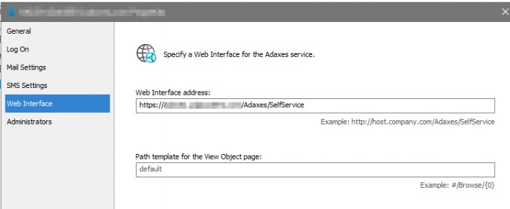

For the Web Interface Address, I meant in here for the email URL's Adaxes CWA.png
Hello Matt,
Thank you for clarifying. The setting you are referencing does not influence the actual URLs for accessing Web interfaces. It is used to specify the Web interface URL that will be used to embed links to directory objects into exported report documents, approval request notifications, etc. If you change the URL to something different from Adaxes Web interface one, the embedded links will simply stop working.
