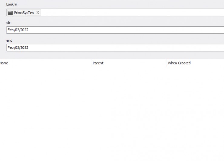

hello permission to ask about how to make a report based on time span, in my case, I want to create a report of the recently created user but the result of my script execution doesn't show anything.
here is the script from my code:

Output Script:
by (100 points)
by (303k points)
To achieve the desired behavior, there is no need to use scripts. You can have the report generated based on search and use the following LDAP filter:
(&(sAMAccountType=805306368)(whenCreated>=%param-str:format[yyyyMMddHHmmss.0Z],,,utc%)(whenCreated<=%param-end:format[yyyyMMddHHmmss.0Z],,,utc%)(|(!(msExchRecipientTypeDetails=*))(!(msExchRecipientTypeDetails:1.2.840.113556.1.4.804:=7276219883574))))
