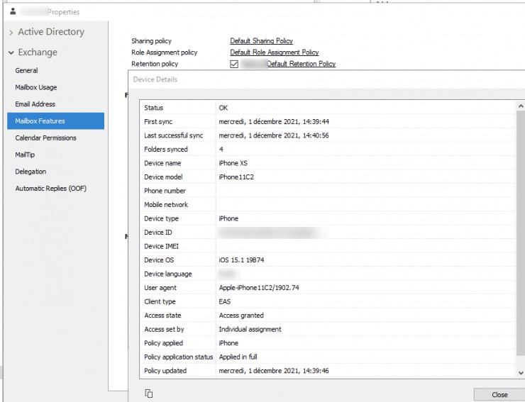

We need a report or a custom command that export all Active Sync devices details. Is there a way to do it ?

Hello Michel,
What exactly do you mean by Active Sync devices details? Could you, please, provide a live example of the desired report? You can post it here or email at support@adaxes.com.
by (200 points)
For each devices we need the user name and all informations showed in Device Details.
Hello Michel,
Thank you for clarifying. Unfortunately, there is no possibility to make such a report due to the number of columns. As a solution, you can have a custom command with a PowerShell script. The script can create a CSV file with all the data and deliver it via email. Does the approach meet your needs?
by (200 points)
Hello, thank you for your answer.
Yes, it will meet our need.
