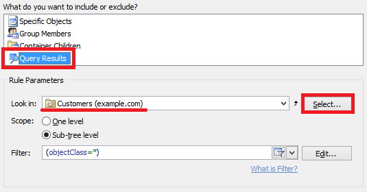

  1. Create a new Business Unit.
  2. On step 2 of the Create Business Unit wizard, click Add.
  3. Select Query Results.
  4. Click the Select button associated with the Look in field.
  5. Select your Customers OU and click OK.

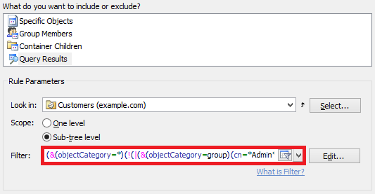

  6. In the Filter field, specify the following LDAP filter:
    (&(objectCategory=*)(!(|(&(objectCategory=group)(cn=*Admin*))(distinguishedName=OU=Customers,DC=example,DC=com))))
    where OU=Customers,DC=example,DC=com is the Distinguished Name (DN) of your Customers OU.
  7. Click OK, and then click Finish.
