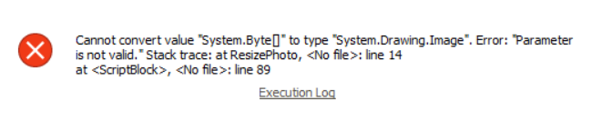

I am trying your suggestions now but none work, this is I think caused by not decoding the base64 before trying to resize it.

The error I am getting: RoyalTS_K3qPqsENYm.png

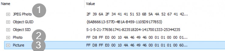

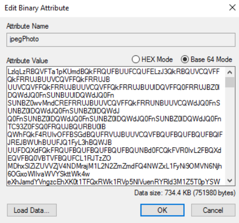

  1. Sync users; API puts the base64 encoded string into jpegPhoto (the only native AD attribute to accept it.)
  2. Then I take that string and put it into the decode website I mentioned.
  3. I put this string into the attribute photo.
  4. Then I can use the script (https://www.adaxes.com/script-repository/update-user-photo-in-ad-and-microsoft-365-from-binary-attribute-s616.htm) to make it suitable for "ThumbNailphoto" and in the end I have a working photo there.
In screenshot form: ydxGejmhmN.png

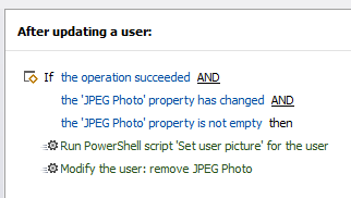

Thank you for clarifying. If you save the base64 code into an attribute using Adaxes pipeline, you can use a business rule triggering After updating a user with the script that will use the decoding part you provided in the previous post. The rule will look like the following: image.png The below script should do the trick:
$binaryPropertyName = "jpegPhoto" # TODO: modify me
# Get picture to set
$encodedValue = $Context.TargetObject.Get($binaryPropertyName)
$valueToSet = [System.Tex.Encoding]::ASCII.GetString([System.Convert]::FromBase64String($encodedValue)
# Update the user
$Context.TargetObject.Put("thumbnailPhoto", $valueToSet)
