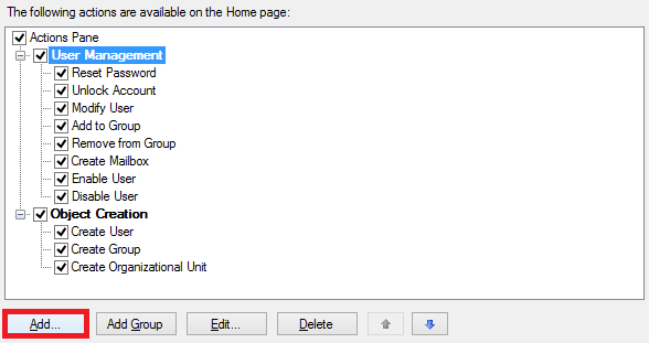

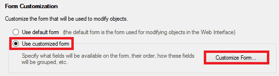

For this purpose, you can create actions available on Adaxes Home Page that allow users to view and edit their own properties. In the actions, you can use customized forms and views with a different set of fields.

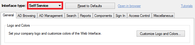

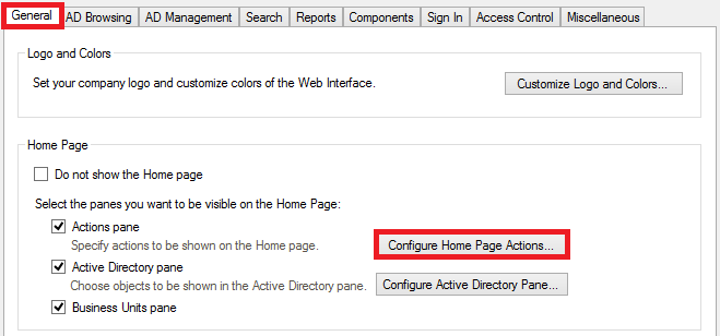

  1. Start the Web Interface Customization tool.
  4. On the Home Page Actions dialog box, click Add.

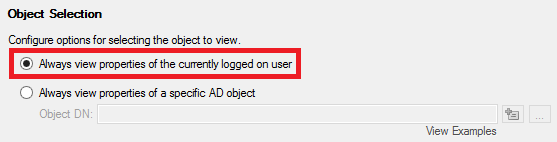

  6. On step 3 of the wizard, select the Always view properties of the currently logged on user option.

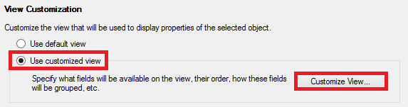

  7. On step 4, select Use customized view and select Customize View to configure the view that will be used for the action. For information on how to customize the view, see the following tutorial, starting from step 6: http://www.adaxes.com/tutorials_WebInte ... tomization.

Edit Own Properties
To create an action that allows users to edit their own properties:
  1. Click the Add button on the Home Page Actions dialog box again.
  2. On step 1 of the Add Home Page Action wizard, select Modify, and then select User in the associated drop-down list.

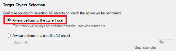

  3. On step 3, select the Always perform for the current user.
  4. On step 4, select Use customized form and select Customize Form to configure the view that will be used for the action. For information on how to customize the view, see the following tutorial, starting from step 6: http://www.adaxes.com/tutorials_WebInte ... tomization.
  5. When done, click Finish.
