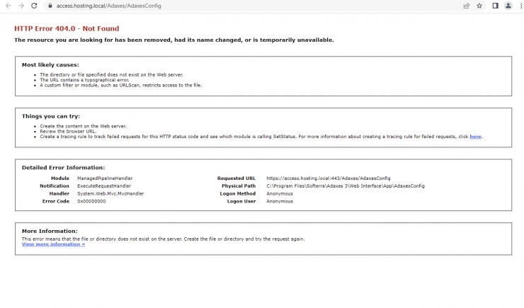

We upgraded to the latest version of Adaxes today but can no longer access the /AdaxesConfig web portal. Getting the error below -
What do we need to do to restore access?
by (480 points)
The error occurs because the URL is not correct. It should be access.hosting.local/AdaxesConfig without the extra Adaxes/ part. If following the URL still takes you to the current URL, make sure that there are no redirect rules configured in IIS for the web site that hosts Adaxes Web interface.
by (480 points)
Thanks! I was able to resolve it
