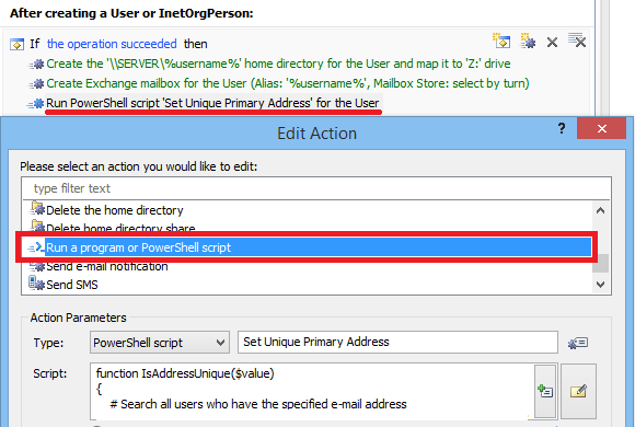

I was wondering if you could help me with configuring email addresses when executing business rules.
Our current policy creates email addresses based on first initial, last name format. For example: (John Smith JSmith@contoso.com)
When creating, we sometimes run the issue of having an email address that already exists and creates JSmith1@contoso.com. We then need to change the address manually to include the second initial of the first name to JoSmith@contoso.com, and if that's taken then JohSmith@contoso.com, etc.
Is it possible for Adaxes to pick this up and programmatically change the email address?
http://www.adaxes.com/tutorials_Simplif ... Script.htm
Example 2 is close to what we need but not quite. Need it for unique email addresses and specifying a specific format.
Thank you!
Yes, it is possible. You can use the following script from our Script Repository: http://www.adaxes.com/script-repository ... s-s331.htm. You need to add the Run a program or PowerShell script action that runs the script in your Business Rule that creates the mailboxes, after the action that performs mailbox creation.
