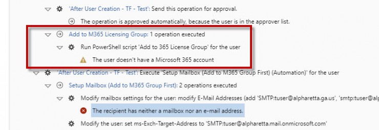

I noticed that I get an error when I execute the "https://www.adaxes.com/script-repository/add-user-to-groups-in-microsoft-365-s578.htm, Add user to groups in Microsoft 365" script after a user account is created. I believe this is because Azure AD does not see the new account and it takes time for replication. Am I correct? If so, is there a way around this issue? I'd like to configure automation so that as soon as a new account is created, that new account will be added to the Microsoft 365 group. The screenshot below just shows the error that occurs when trying to add the user to the M365 group as an automated task after the new user account gets created.

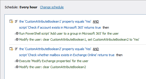

Thank you for specifying. To achieve the desired, you need to create the related Microsoft 365 account first. To do so, you can use the Activate or modify Microsoft 365 account action executed in the business rule triggering After creating a user. In the action configuration, do not select any licenses, just activate the account and it will create a user in Microsoft 365. However, the account creation takes some time. To be sure that the account actually exists before adding it to the Microsoft 365 group, the following approach can be used. You can mark the account by setting, for example, a custom Boolean attribute to True in the business rule triggering After creating a user. Then create a scheduled task that will check whether the user is marked and whether the account actually exists in Microsoft 365. If the conditions are met, the task will run the script that adds the user to the required group and clear the custom Boolean attribute. To check if the user is marked, use the If \ \ \ condition. To check if the account exists in Microsoft 365, run the below script in the If PowerShell script returns True condition.

Regarding the modification of the mailbox properties. The mailbox gets created once the user gets the Microsoft 365 license assigned that grants access to Exchange Online. The mailbox creation takes some time as well. It means that you can use the same approach with marking the users and then processing them in a scheduled task. The task will check if the user is marked and has a mailbox in Exchange Online. If the conditions are met, the task will execute the custom command modifying Exchange properties. To make sure that a mailbox exists in Exchange Online, the following script from our repository can be used: https://www.adaxes.com/script-repository/check-whether-user-has-mailbox-in-exchange-online-s303.htm. Finally, the task will clear the custom Boolean attribute used as the mark. Both, the addition to the group and mailbox modifications can be done in a single scheduled task. The task configuration should look like the following:

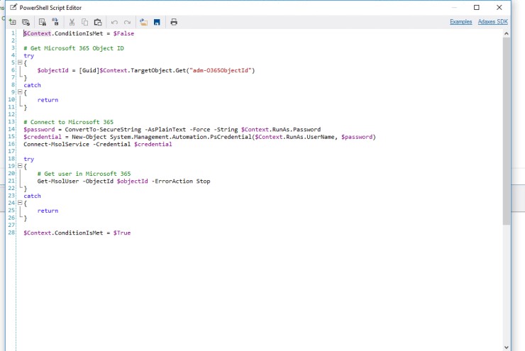

Is there a new updated script to check if an account exists in Microsoft 365? The current one stopped working for me.
This script:
There were no changes in Adaxes 2023 that might affect your script. As per our check, it should be working fine. If you face any issues, please, describe them in all the possible details with live examples.

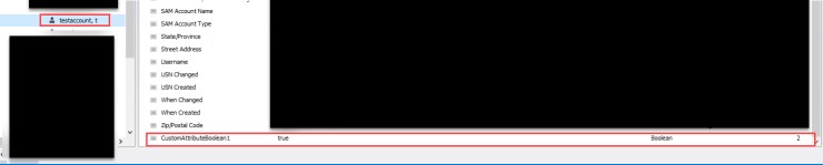

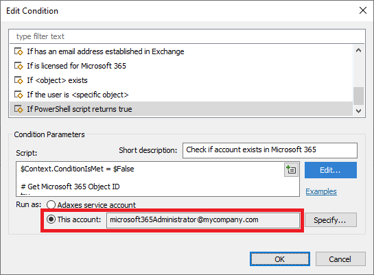

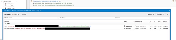

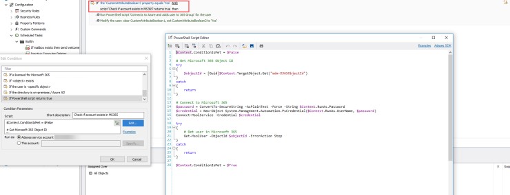

After creating a user, we have an action that adds a CustomAttributeBoolean1 and sets it to true. We then have a scheduled task with two conditions: 1. checks if the CustomAttributeBoolean1 property is true 2. The script that returns true if the new user account exists in MS 365. If both conditions are met then there is another scipt that connects to Azure and adds the user to the Microsoft 365 License group. I've tested the scheduled task by removing the 'check if account exists in MS 365' script and the task was successful. The portion that does not seem to work is the script. I've also confirmed that the account does exist in MS 365 by logging in and searching for it.
Screenshot of boolean attribute on the new test account:
Screenshot of the script that checks if account exists in MS 365 then returns 'true' if it exists (Note: we tried both Run as: 'Adaxes service account' and 'This account' options):
Screenshot with the script removed and the activity history shows that the task worked successfully:
The script only works when the credentials are specified in the This account option of the Run as section. Also, it has to be an account which has corresponding permissions in Microsoft 365.

As a test, I've ran the script with my own credentials and it did not work. My credentials have the correct permissions in Microsoft 365.
Also, looking at the Microsoft 365 properties for the test account in the Adaxes Admin Console and yes I see them properly.
I will contact Adaxes Support for further troubleshooting.
