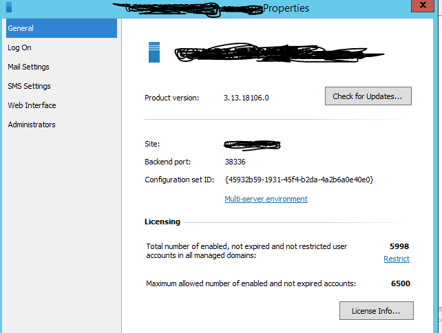

We need your help, as we are trying to activate the license but we are not able to see that option.
Please find the below screenshot for your reference.
by (3.6k points)
Hello Manoj,
The thing is that you are using an old version of Adaxes while the instructions you are referencing are only for the latest version. To activate your license key:
  1. Unzip the license.zip archive.
  2. Navigate to the folder where Adaxes Service is installed, which is C:\Program Files\Softerra\Adaxes 3\Service by default.
  3. Open the License folder.
  4. Copy your license key file (license.admlic) to the folder.
  5. Restart Adaxes service.
If you have multiple instances of Adaxes service sharing common configuration, activate your license key for each instance.
