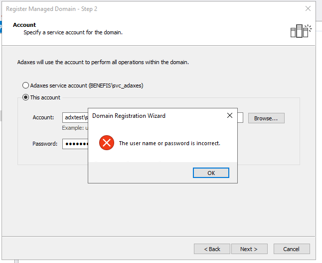

In order to add a managed domain does it have to be trusted by the primary domain adaxes is installed an running in?
I have set up a domain for testing adaxes and it is not trusted by our production domain. When I try to add the user account when setting up the managed domain it errors out bad username and password. I have set my host file to point the untrusted domain to it's primary Domain Controller.

For troubleshooting purposes, please, provide us with a screenshot of the error message you are facing. Also, please, specify when exactly it occurs. You can post the screenshot here or send to us at support@adaxes.com.
Also, please, make sure that there is no other software (e.g. antivirus) that might block the connection.

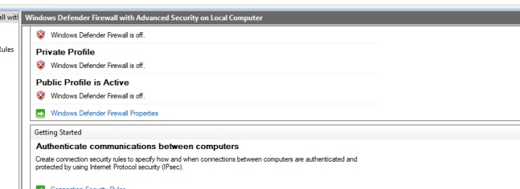

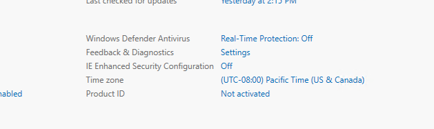

when trying to specify a service account for the domain is when the error occurs. I have turned off windows fire wall image.png Antivirus is turned off image.png
