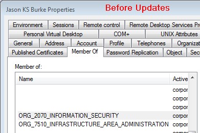

OK, here is where we are at with this. We updated the code per your recommendation but are still receiving an error when running it.
Our test user in this particular case is a member of two Department (ORG_) groups currently. One incorrect department group, and the correct group they should be in. This script should take a pass at the account, check the department attribute, update the account with the corresponding department group, then remove any other "ORG_" groups on the account....next account.
Here is a screenshot of the user in AD belonging to the two groups:
The user's "DepartmentNumber" attribute currently is 7510

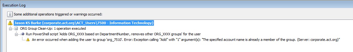

Running the code I'm attaching at the bottom, this is the error we receive

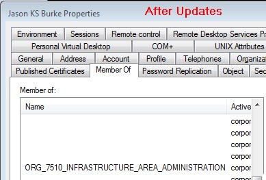

This is the end result we would like to see in this particular example

Hello Ben,
Thank you for the details. Find the updated script below.
