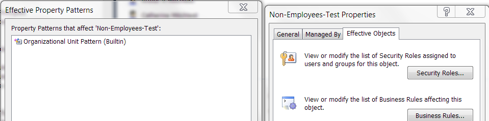

Can you check how many Property Patterns configured for the User object type are applied to the OU where you create new user accounts? For information on how to do that, see the following help article: http://www.adaxes.com/help/?ManagePrope ... jects.html.
Here is the screen capture of the Property Patterns associated with the OU:
(Effective Property Patterns for the OU)

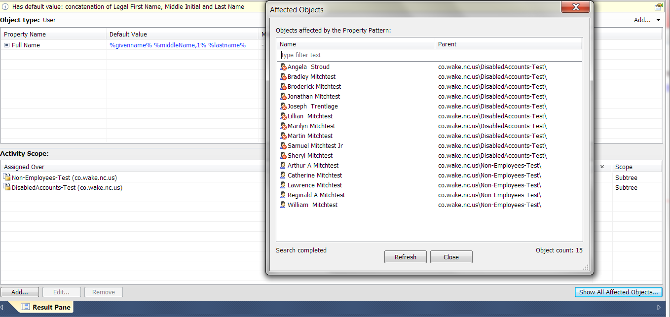

When I select one of the property patterns and Show All Effected Objects, this is what I see:
(Result of Show All Affected Objects for one of the property patterns)
