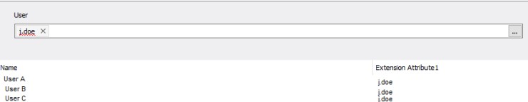

I am trying to create a report, that searches the extension attribute40 of all users for a username. I tried the report with "Active Directory search (param-Username)" and script. I would be glad about a tip

I'm looking for an report, which lists all users with value (user) in an extension attribute. If I build the report it works only for one user.
Result should be:

Thanks for your help. :-) I need more a report like this:
$filter = {
extensionAttribute2 -like '%param-User%'
} Get-AdUser -Filter $filter | select name | Sort-Object name
Works in PS but not in the script of the report.

Thank you for the confirmation. What exactly do you want to select in the parameter for report generation? Should it be an object picker? Also, what values do you have stored in the extension attribute? Is it a distinguished name (DN) of a user?
