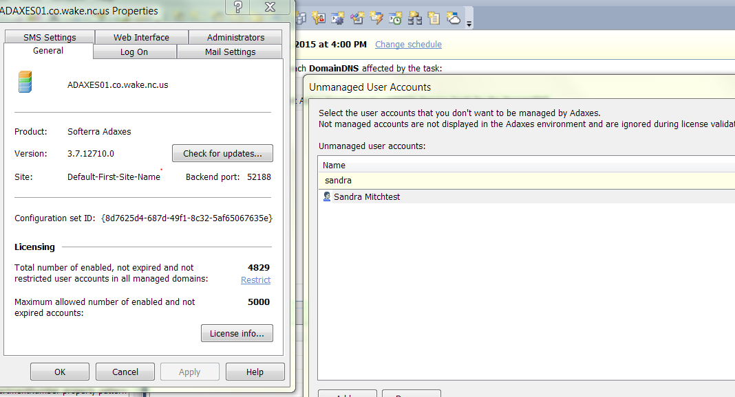

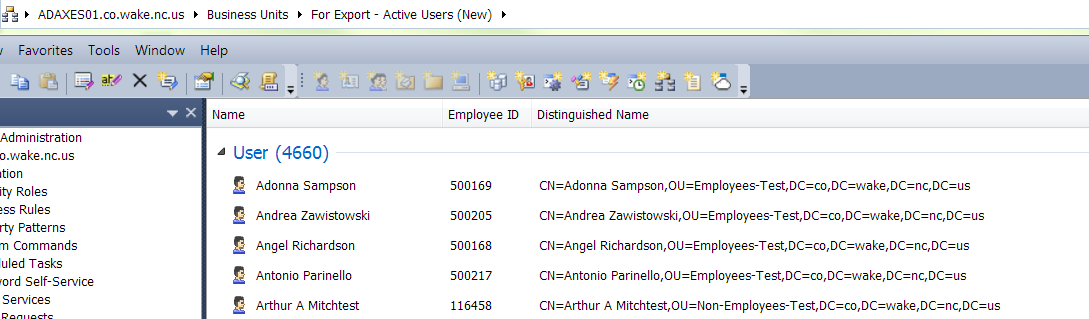

I have a scheduled task that exports the members from a Business unit. However the number of members in the Business Unit (4648), does not equal the number of rows exported (4738). I can identify some of the extra records, but when I search for them in the Adaxes Console using the LDAP search, I don't find them, so I have no idea where these are being picked up from. I don't have any extra processing going on in my scheduled task that could account for the retrieving of records outside of what's contained in the Business Unit.
If someone could point me in the direction of where else I could look to determine the discrepancy, I would greatly appreciate it.
by (870 points)
Backup configuration file attached...

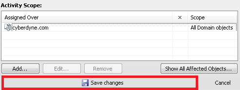

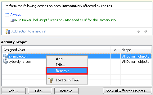

The thing is that you included 2 domains in the Activity Scope of the Scheduled Task that sets Unmanaged Accounts. Because of this, the script used in the task runs 2 times within a short period of time. Since Adaxes needs some time to rebuild the list of Unmanaged Accounts, running the script for the 2nd time interrupts the process and can cause the issue with calculating the number of managed accounts.
To remedy the issue, you need to remove one of your domains from the the Activity Scope of the task. It does not matter which one. By the design of the script, a domain specified in the Activity Scope only triggers execution of the script. The Activity Scope does not affect the scope of AD users added to Unmanaged Accounts. The scope of managed / unmanaged accounts is specified directly in the script.
To do this:
  1. In the Activity Scope section of the Scheduled Task properties, right-click any of the domains and select Remove.
  2. Click Save changes.
  3. Before re-checking the issue with the Business Unit, wait for the Scheduled Task to run based on the schedule or run it manually.

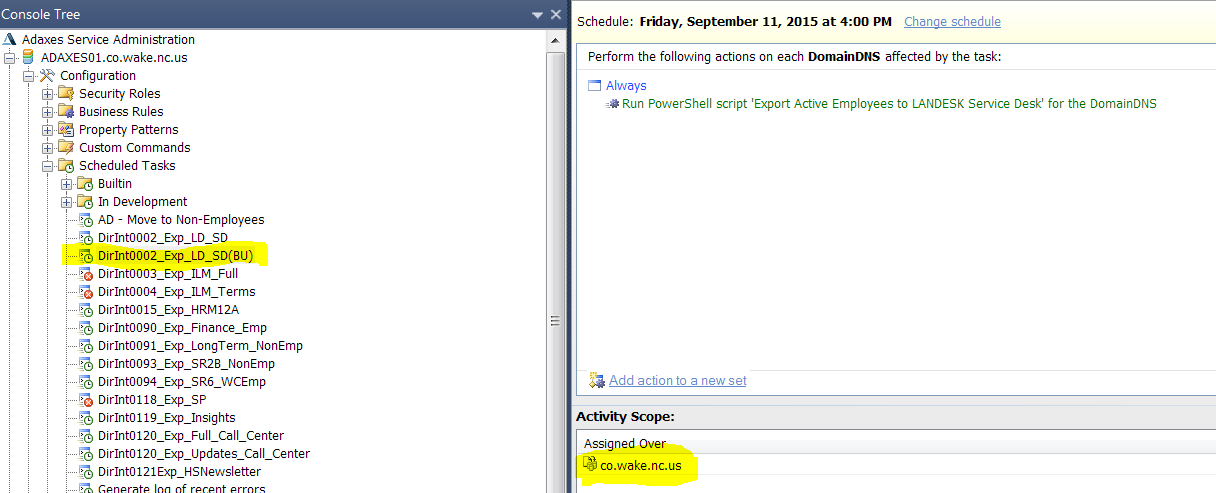

The scheduled task that uses the Business Unit only has one Activity Scope Assigned Over domain selected. I believe you were looking at the original Scheduled Task created before using the Business Unit. See attached screen capture:
(Scheduled Task Activity Scope)
It seems like we've found the cause for the issue. You have 2 Scheduled Tasks that have almost the same functionality, but have a very important difference between them: DirInt0002_Exp_LD_SD and DirInt0002_Exp_LD_SD(BU). Both the tasks build a report, the format is the same, both the tasks use the same LDAP filter to search for users, and, which is more important, both the task save results to the same CSV file.
The difference is that the DirInt0002_Exp_LD_SD(BU) task creates reports on the basis of members of a Business Unit, which means that it will include only managed user accounts. The DirInt0002_Exp_LD_SD task uses a LDAP search to build reports, and the search is configured so that both managed and unmanaged accounts are returned.
It looks like the 2nd task simply overwrites the CSV file created by the 1st task, hence the difference. To check this, try disabling the DirInt0002_Exp_LD_SD Scheduled Task. Then, tun the DirInt0002_Exp_LD_SD(BU) task again.
I am not running both of the scheduled tasks. The one without the '(BU)' at the end is the initial scheduled task created that is no longer being used because it wasn't able to look at two different OUs and compile the result in one CSV. I'm ONLY running the one with '(BU)' at the end and not on a schedule yet since we're still in the Development stage of the project. The 'conflict' scheduled task hasn't run since July 25th, 2016, so this cannot be the issue. Please tell me what's been done to recreate my issue. Did you 'import' our service image onto a VM and actually run the scheduled task? Is there some other way that we can resolve this via a Remote session into our environment? It feels like we're just spinning our wheels!!!
We did import your configuration, and we did test your Scheduled Tasks and Business Unit. The issue didn't get reproduced with the DirInt0002_Exp_LD_SD(BU) Scheduled Task until today. It looks like in certain conditions, the IAdmBusinessUnit::Members() method can indeed return Unmanaged Accounts. We are sorry for the inconvenience.
