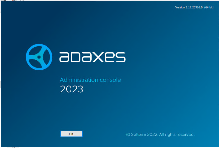

Thank you for clarifying. For us to help you with the script, please, specify the version of Adaxes you are currently using. For information on how to check it, have a look at the following help article: https://www.adaxes.com/help/CheckServiceVersion.
by (1.2k points)
