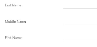

It's not often that the script is used, so I'm just getting back to you. In case of the change to "%firstname:lower%.%lastname:lower%" (2nd approach) there is always the problem that the following business rules don't work anymore, because the UPN is then always "firstname.lastname@" without domain ending
In this case there seems to be an error in the script, can you reproduce this?Unbenannt.jpg****
by (307k points)
Hello Boris,
Sorry for the confusion, but with the current screenshot we are not able to provide any insight on the issue. If you cannot post an uncovered screenshot here, please, send it to us at support@adaxes.com. Also, please, send a screenshot of the business rule itself.
