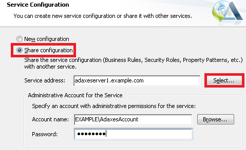

2.Alternatively, you can do as follows:
  1. Install Adaxes Service on another computer and share the service configuration with your current service. To do this, on the Service Configuration page of the installation wizard, do the following:
    • Select Share configuration.
    • Click Select.
    • Select the server where Adaxes service is installed at the moment.
    • Specify credentials of Adaxes default service administrator (the user that you specified when installing Adaxes service).
  2. When the installation completes, launch Adaxes Administration Console and connect to the new Adaxes service. Once connection is established, this means that the new service has replicated configuration information from the old one.
  3. Stop Adaxes Service.
  4. Replace the AdaxesLog.db3 file of the new service with the necessary one.
  5. Start Adaxes Service.
  6. Perform the export using the script from the repository.
