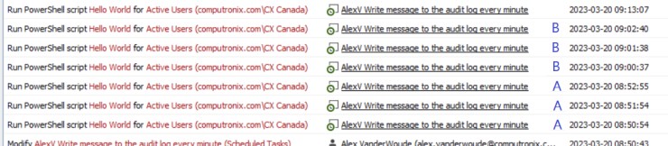

Please note that I'm content with the behavior of the product, and I'm not requesting any kind of fix/change.  However, because you are interested, here is a what I had set up:
I created a new Scheduled Task that ran the following PowerShell script once every minute:
$now = (Get-Date -Format G)
$Context.LogMessage("Current datetime is $now", "Information")
As described in my previous comment, I let the ST run a few times (A in the screen snapshot). Then I closed the Admin Console and stopped the service for a few minutes.  After that I restarted the service and opened the Admin Console again.  After the reconnection I examined the Logging section, and saw that there were some "catching up" STs (B in the screen snapshot).
image.png However, looking at the Properties of the ST showed that the Next run on that ST was at 9:01 -- that is, before the most recent logged item at 9:02:40.  Therefore, no further items appeared in the Logging section.  I do not have a screen snapshot of that, because eventually I disabled and re-enabled the ST.  This resulted in the top-most line in the above image, at 9:13:07.
I hope you find this information helpful.  But to re-iterate, I'm not looking for any changes to the product.  I do not plan to schedule intervals as short as once per minute.
