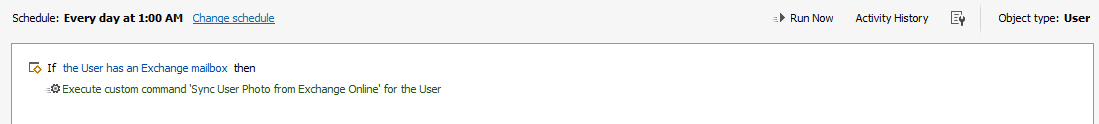

It is a known issue when using the Import-PSSession in PowerShell 3.0 and higher. As a solution, we recommend adding the If PowerShell script returns true condition to your Custom Command that will check whether the user has a mailbox in Exchange Online and update your script accordingly. In the condition, you need to use the following script from our repository: https://www.adaxes.com/script-repositor ... e-s303.htm.
In the action of the Custom Command, the following script should be used:
    # Connect to Exchange Online
    $session = New-PSSession -ConfigurationName Microsoft.Exchange -ConnectionUri "https://ps.outlook.com/powershell/?proxymethod=rps" `
    -Credential $Context.GetOffice365Credential() -Authentication Basic -AllowRedirection -WarningAction SilentlyContinue
    Import-PSSession $session -AllowClobber -DisableNameChecking -CommandName "Get-UserPhoto"
    $pictureBytes = Get-UserPhoto %userPrincipalName%
    $Context.TargetObject.Put("thumbnailPhoto", $pictureBytes.PictureData)
    if ($session) { Remove-PSSession $session }
Finally, the Custom Command will look like the following:
