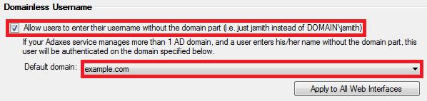

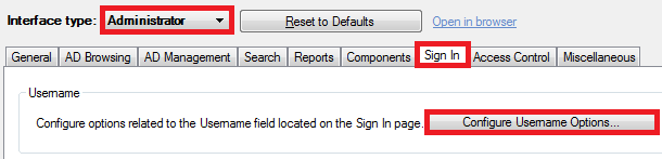

You can configure Web Interface Sign In page for users to enter their usernames only. It will require specifying a Default domain for the Web Interface. To do so:
  2. Select the Web Interface type and active the Sign In tab.
  3. Click Configure Username Options.
  4. Select Allow users to enter their username without the domain part .
  5. Select the Default domain (ad.example.org in your case) and click Apply.
