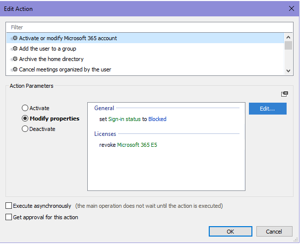

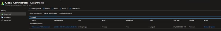

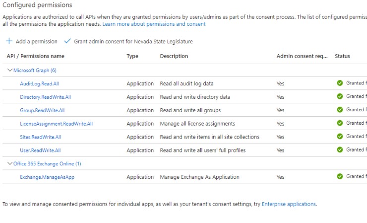

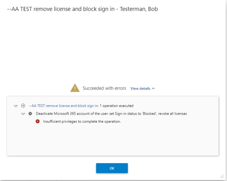

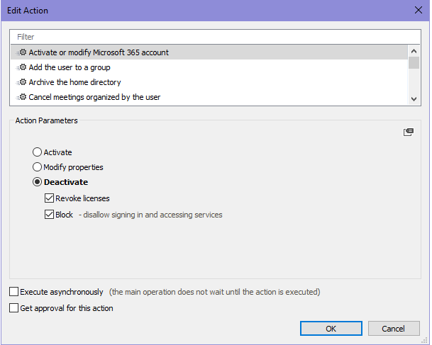

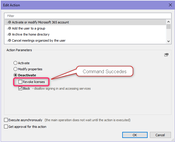

I have a custom command, copied from the buit-in deprovisioning script, that revokes all licenses and blocks sign in; however, I get an insufficient permissions error on the revoke all licenses. The app is a Global Administrator and has the following permissions: image.png I've tried using two methods setting this command up. First, just like the built-in script: image.png And secondly like an example I found on the web: image.png The only time I get a success on the command is when I uncheck the Revoke Licenses checkbox, but of course, no licenses are revoked. image.png This is the error I get: image.png

Thanks for the reply, but as I said, the app is a Global Administrator. image.png Do you know of anything else that might be blocking the app from revoking licenses? As I said, it can assign a license with no problems. I'm going to turn on verbose logging again to see if I can narrow it down a bit.

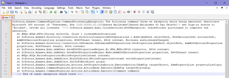

I removed the Microsoft 365 tenant registration and recreated it and the issue seems to be resolved. I do know that it was registered with the App credentials but it is possible that those credentials changed on the app at some point when we were setting everything up. Hard one to find because creating and licensing a user worked just fine and even blocking a 365 sign in worked. We only had an issue revoking a license. Thanks for your help.
