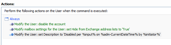

We need to be able to put the name of the person requesting a account be disabled into the following custom command. We have in the past changed the description line to reflect the following: 'Disabled per {requestor} on current date and time by {Helpdesk username}. We tried using the variable %input% in the script below but it did not stop and allow input. Can you advise?

In the template you are using for Description field value references (except for those containing initiator) are resolved from the Custom Command target object. To achieve what you need, Help Desk operators will need to enter the name of the requestor into one of DN syntax attributes of the target account (e.g. seeAlso) that is not in use and then execute the Custom Command.
The template for Description field in the Custom Command should be as follows: Disabled per %seeAlso% on %datetime% by %initiator%.

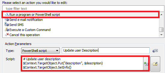

This can be achieved using a PowerShell script. To do so:
  2. Navigate to the Custom Command and select it.
  3. Double-click Modify the user action.
  4. Select Run a program or PowerShell script.
  5. Enter a short description and paste the following script into the Script field:

    The {0} placeholder in the template will be replaced with the name of the user specified in the See Also field.
  6. Click OK and save the changes.
