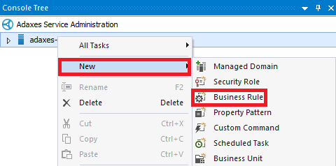

Thank you for the confirmation. To create the Business Rule:

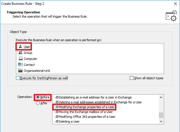

  4. On step 2 of the Create Business Rule wizard, select User Object type.
  5. Select Before Modifying Exchange properties of a User and click Next.

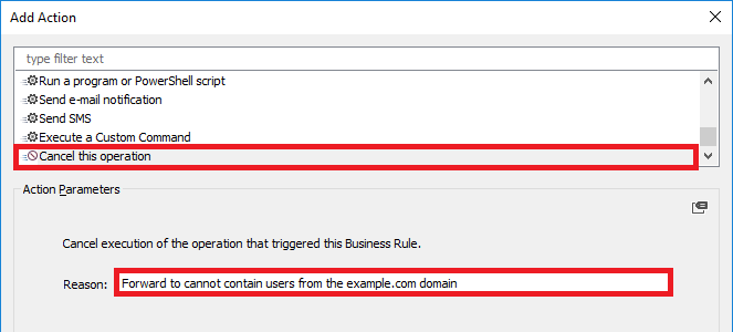

  6. Click Add an action.
  7. Select Cancel this operation.
  8. Specify a cancellation reason and click OK.

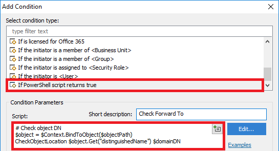

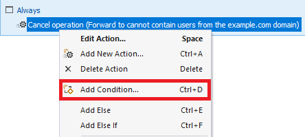

  9. Right-click the action you created and then click Add Condition.
  10. Select If PowerShell script returns true.
  11. Paste the below script into the Script field. In the script, the $domainDN variable specifies the distinguished name (DN) of the domain (e.g. DC=example,DC=com).
     $domainDN = "DC=example,DC=com" # TODO: modify me
     function CheckObjectLocation($objectDN, $domainDN)
         $objectDN = New-Object "Softerra.Adaxes.Ldap.DN" $objectDN
         $Context.ConditionIsMet = $objectDN.IsDescendantOf($domainDN)
     # Get Exchange properties set by the action
     $modifiedMailboxParams = $Context.Action.MailParameters
     if (-not($modifiedMailboxParams.MailFlowSettings.DeliveryOptions.ForwardingAddressModificationEnabled))
     # Get forwarding address
     $forwardingAddress = $modifiedMailboxParams.MailFlowSettings.DeliveryOptions.ForwardingAddress
     if ($forwardingAddress.ObjectDN)
         CheckObjectLocation $forwardingAddress.ObjectDN $domainDN
     elseif ($forwardingAddress.ObjectGuid)
         $objectPath = "Adaxes://<GUID=" + $forwardingAddress.ObjectGuid + ">"
     elseif ($forwardingAddress.ObjectSid)
         $objectPath = "Adaxes://<SID=" + $forwardingAddress.ObjectSid + ">"
         $Context.LogMessage("Unable to get object path: " + $forwardingAddress.Identifier, "Error")
     # Check object DN
     $object = $Context.BindToObject($objectPath)
     CheckObjectLocation $object.Get("distinguishedName") $domainDN
  12. Enter a short description and click OK.
