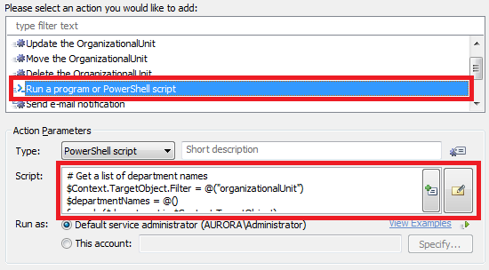

  4. On the 3rd step, add the Run a program or PowerShell script action and paste the following script:

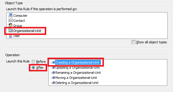

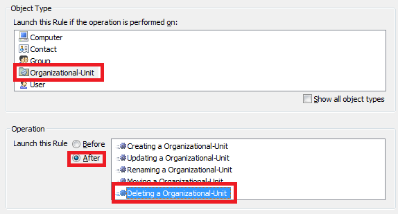

  2. On the 2nd step:
    • for the Business Rule that will be executed after creating an OU, select Organizational-Unit and After Creating an Organizational-Unit;
    • for the Business Rule that will be executed after deleting an OU, select Organizational-Unit and After Deleting an Organizational-Unit.

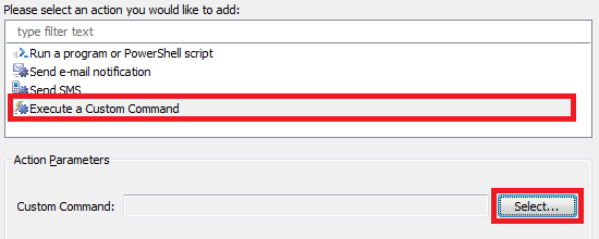

  3. On the 3rd step, add the Execute a Custom Command action and click Select.
  4. In the dialog box that appears, select the Custom Command that you created on step I.

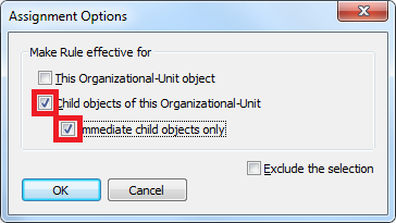

  6. On the 4th step, assign the Business Rule over your Departments OU and specify the Child objects of this Organizational-Unit and Immediate child objects only in the Assignment Options dialog.

  3. On the 4th step, add the Execute a Custom Command action and click Select.
