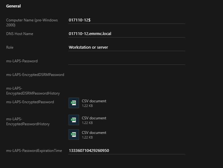

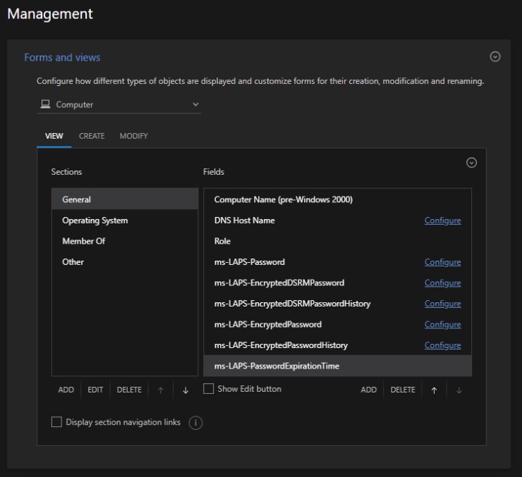

We are implementing the new version of LAPS built into Windows 10 with KB5025221. I've added the attribute to the Management Views for Computers, but the password is not being decrypted. I've added the Adaxes Service Account to permissions for LAPS password decryption as well. image.png
The old LAPS Attribute (ms-Mcs-AdmPwd) is not available, as we have not loaded it into AD and plan to use the latest implementation of LAPS.

Thank you for the provided details. Unfortunately, there is no possibility to achieve the desired with the update. We keep monitoring the possibilities provided by LAPS. Should there be any updates, we will investigate existing approaches that could be used in Adaxes.
