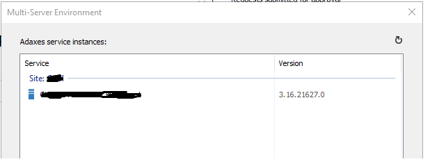

For us to suggest a solution, please, provide us with the below details. You can post them here or send to us at support@adaxes.com.
  • A screenshot of the Multi-server environment dialog. The dialog displays how many Adaxes services you have and what their versions are. For information on how to view it, see https://www.adaxes.com/help/MultiServerEnvironment.

Yes, you are right, sorry for missing it. As we can see, you are using Adaxes 2023.2 and the script from built-in report Passwords changed long ago. Starting with version 2023, criteria was added to Adaxes and that is something you should use instead of LDAP filters. For details on how to build criteria, see https://adaxes.com/sdk/HowDoI.BuildCriteria. We updated your script accordingly and added the options you requested. Here is the final script:
