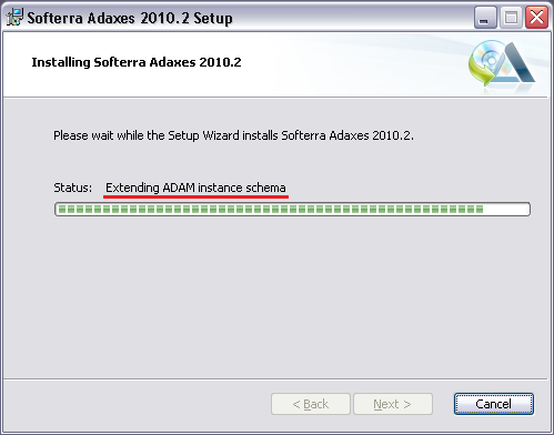

1. Does the Extending ADAM instance schema operation fail immediately or after a delay? (see image attached)
2. Please check whether ldif.log or ldif.err files exist in the temp directory of the user who launches the installation. If not, please try to search for these files on your system.
I tried again on a 3rd server in a different domain that uses a different build process, Windows Server 2008 x64 standard.
Same result, using the 64 bit english download.
It stops immediately, a search of the c drive for ldif* finds nothing.
