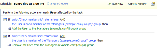

To create the Scheduled Task:
  1. Launch Adaxes Administration Console
  3. On step 3 of the Create Scheduled Task wizard select User Object type.

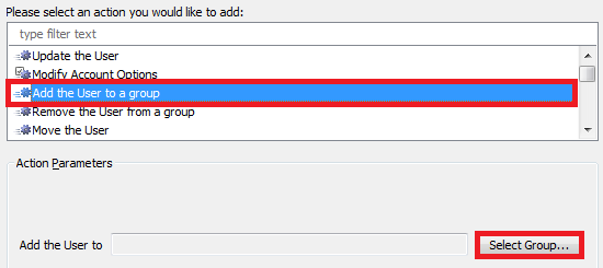

  4. Click Add Action, select Add the User to a group and click Select Group.
  5. Select a group and click OK twice.

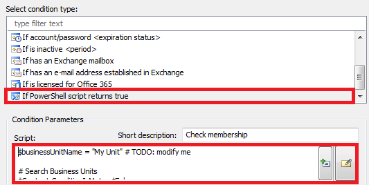

  6. Double-click Always and select If PowerShell script returns true.
  7. Enter a short description and paste the following code into the Script field.

  8. Click OK.

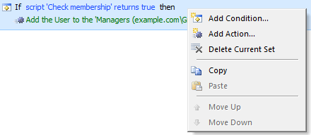

  9. Right-click the set you have created and click Add Condition.

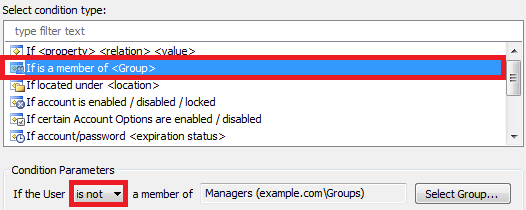

  10. Select If is a member of and click Select Group.
  11. Select the same group as in step 5 and click OK.
  12. Select is not and click OK.
  13. Right-click the set again and click Copy.
  14. Right-click the free space and click Paste.

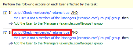

  15. Double-click the first condition in the second set and input the following code into the Script field.
     $businessUnitName = "My Unit" # TODO: modify me
     # Search Business Units
     $businessUnitsPath = $Context.GetWellKnownContainerPath("BusinessUnits")
     $searcher = $Context.BindToObject($businessUnitsPath)
     $searcher.SearchFilter = "(&(objectCategory=adm-BusinessUnit)(name=$businessUnitName))"
     $searcher.PageSize = 500
         $units = $searchResult.FetchAll()
         if ($units.Count -eq 0)
             $Context.LogMessage("A Business Unit with name '$businessUnitName' was not found", "Warning")
         foreach ($unit in $units)
             # Bind to the Business Unit
             $unitObject = $Context.BindToObject($unit.AdsPath)
             # Check whether the target object is a member
             if ($unitObject.IsMember($Context.TargetObject))
         # Release resources used by the search
         $searchResult.Dispose()
  16. Click OK and double-click the second condition in the second set.
  17. Select If the user is member of and click OK.

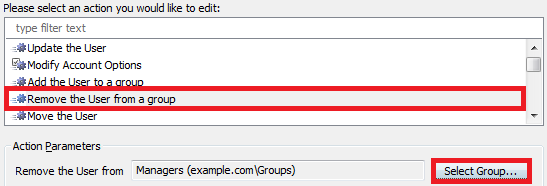

  18. Double-click the action in the second set and select Remove the User from a group.
  19. Click Select Group and select the same group as in steps 5 and 11.
  20. Click OK twice.
  21. Click Next and finish creating the Scheduled Task.
You Should have something like the following:
