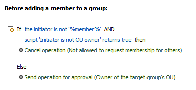

Then, you will need to set up an approval step. A Business Rule that triggers Before adding a member to a group and sends the operation for approval to the Owner of the target group's OU should be used for this purpose. Also, this Business Rule should have a If the initiator is not %member% condition that will check whether a user is requesting membership for someone else, and will cancel the operation if they are. Optionally, you can make an exclusion for OU owners and allow them adding other members by their own initiative. The Business Rule should be assigned over the same Business Unit (the one which contains all security groups).
Example Business Rule

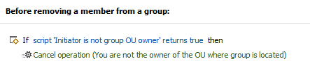

To prevent users from removing group members they are not authorized to remove, you need another Business Rule that triggers Before removing a member from a group. This rule will have a If PowerShell script returns true condition that will check whether the initiator of the Remove member operation is the owner of the OU where the group is located, and cancel the operation if they aren’t.

Thank you for the helpful response. Do you have an example of a powershell script condition I could use to check whether the initiating user is a member of the OU owner group?
by (3.6k points)
+1
Do we understand you correctly, that you need a script that will check whether the initiator of the Remove member operation is the owner of the OU where the target group is located? If this is the case, you can check out this script from our repository. It should be used in the If PowerShell script returns true condition of the Business Rule triggering Before removing a member from a group.
The script will return True if the initiator is not the OU owner. Please note, that the script will also return True and cancel the operation if the OU where the group is located has no owner. It will be impossible to remove members from this group until an owner is assigned to its OU.
The Business Rule itself should look like this: business-rule.png

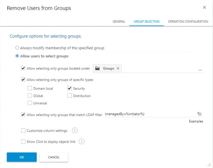

One final question. Is it possible to restrict the groups that these OU owners can see from their dashoard? I'd like to only present them with the security groups which they are the OU owners for. Ideally i'd like to implement something like the following LDAP filter string:
Is something like this possible using LDAP filters?

We noticed that you have asked a question about how to assign an OU owner as the owner of all groups under this OU.
If you are going to implement this, you will be able to use this LDAP filter in your Web Interface action: (managedBy=%adm-InitiatorDN%).
However, it will work only if the initiating user has direct ownership over groups, i.e. this user is explicitly specified in the managedBy attribute of a group.

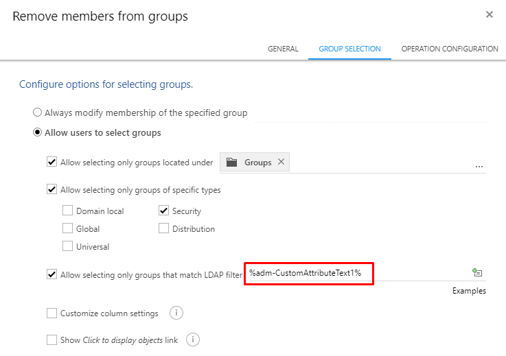

Unfortunately, there are no such plans at the moment. As a workaround, you can create a Scheduled Task which will run this script, and assign the task over OU owners or all users. The script will periodically check which objects are managed by a user, build an LDAP filter for these objects, and save the filter in the specified attribute of a user, for example CustomAttributeText1.
You will then be able to use a value reference to retrieve the LDAP filter for group selection in your Web Interface action: image The filter will be different for each logged on user and will include all objects managed by the user (both, directly and via group membership). Please note, that you need to use %adm-CustomAttributeText1% and not (managedBy=%adm-CustomAttributeText1%), as the attribute will contain the entire filter.
