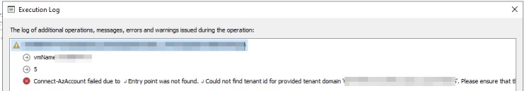

by (2.2k points)
So, I installed the Az.Accounts module and tried this script on ISE Editor on Adaxes server, working fine.
As soon as I try same code within Adaxes PS Editor I get error: image.png Error Message Entry point was not found. Could not find tenant id for provided tenant domain 'yyy'. Please ensure that the provided service principal 'xxx' is found in the provided tenant domain. Stack trace: at <ScriptBlock>, <No file>: line 20
Line 20 is Connect-AzAccount command

The error has nothing to do with Adaxes itself. For some reason executing the cmdlet fails due to the entry point not being found. As per our check this has been a known issue with the Az.Accounts module. For details, see https://github.com/Azure/azure-powershell/issues/21952.

According to the article we referenced, it looks like the issue is not present in all the versions of the module. If you have multiple versions installed it might happen so that running in Windows PowerShell ISE picks a version without the issue while Adaxes gets one with the issue. This might be the root cause of the behaviour you face.
