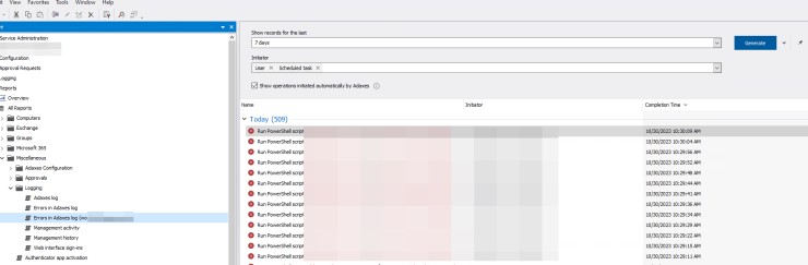

I would like to have a copy of Report "Errors in Adaxes log" and exlcude one or more specific Initiators in this report (cause they are generating a lot of errors sometimes ...)
Can I do this easy with default options? Or do I need to create an own report by script?
by (2.2k points)
There is no easy way to do that as the Errors in Adaxes log report is based on the Adaxes log one. To achieve the desired, you need to copy the Adaxes log report and update the script used to generate it according to your needs. The following article should be helpful: https://adaxes.com/sdk/GeneratingReports.

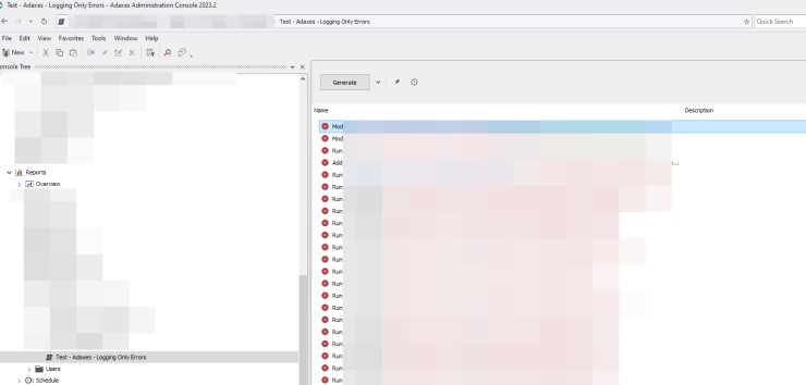

Thanks.
