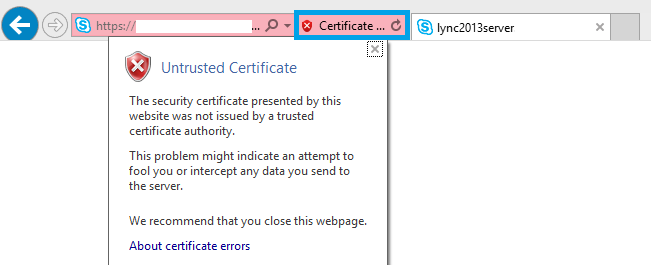

  1. On the computer where Adaxes Service is installed, launch Internet Explorer.
  2. In the address bar, specify the following:
    https://**lyncserver.domain.com**/ocspowershell
    • where lyncserver.domain.com is the fully qualified domain name (FQDN) of your Lync Server.
  3. As soon as the page completes loading, you will get a blank page and a certificate icon in the address bar. Is the certificate icon green (trusted) or red (untrusted)?
by (50 points)
The certificate is trusted.

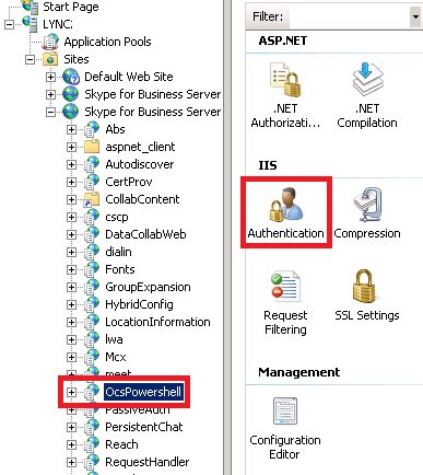

  2. Launch Internet Information Services (IIS) Manager from Control Panel \ Administrative Tools.
  3. Expand the node that represents the Lync Server.
  4. Locate the Ocspowershell web application.
  5. Select it.

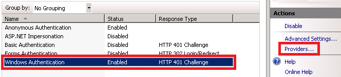

  6. Double-click Authentication.
  7. Which authentication options are enabled / disabled?
  8. Can you select Windows Authentication, and then click Providers? What providers do you see and in which order?
by (50 points)
The providers I have are Negotiate and NTLM.
Hello Joshua,
What about authentication options? Are they the same as above (Windows Authentication and Anonymous Authentication enabled, all other options disabled)?
Also, did you install Windows Management Framework 5 on your Lync Server?
by (50 points)
All of the other authentication options are how they are in your picture. I installed Framework 5 on the servers and I get the same error message.
