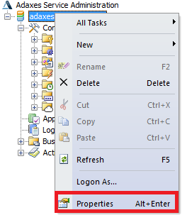

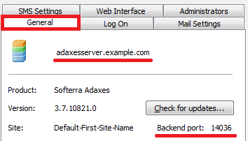

    How to find out the port used by Adaxes configuration server:
    2. Right-click your Adaxes service.
    3. Click Properties.
      The configuration server FQDN and backend port will be displayed on the General tab.
