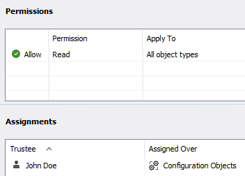

How can I grant read only rights for Configuration items in the Adaxes Admin Console?
by (2.3k points)
Hello Mark,
You can use a security role like the following: image.png However, it will only allow to see reports under containers. If the user selects a report, they will get an error message. For details on how to grant permissions to view reports, see https://www.adaxes.com/help/GrantRightsToViewReports.
by (2.3k points)
Thanks! I tried several other read permissions for specific object types with no luck. This worked!
