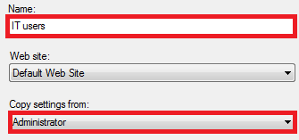

To create a new Web Interface do the following:
  2. Expand the Interface type drop-down list and click New.
  3. Enter the name for the new Web Interface, select an existing Web Interface to copy properties from and click OK.
  4. Once the Web Interface is created configure its Forms and Views. For information on how to do so, check the following help article: http://www.adaxes.com/help/?HowDoI.Conf ... iting.html.
  5. To grant access to the new Web Interface only for IT users check the following help article: http://www.adaxes.com/help/?HowDoI.Conf ... ccess.html.
