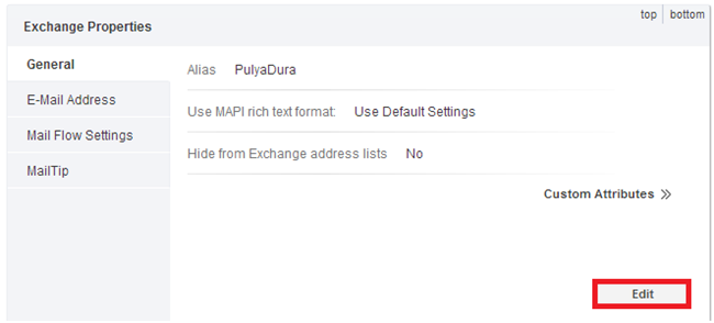

There is no possibility to add Exchange properties section to the Modify Contact Home Page Action. We will consider adding the option in the future releases of Adaxes.
For now, you can use one of the following workarounds:
  1. Create a View ContactHome Page Action. Users will be able to select the Contact and then click Edit in the Exchange properties section to modify Exchange properties of the Contact.
  2. Create an Edit Exchange Properties of Mail-Enabled Contact Home Page Action.
    Users will be able to select the Contact and then edit its Exchange Properties.

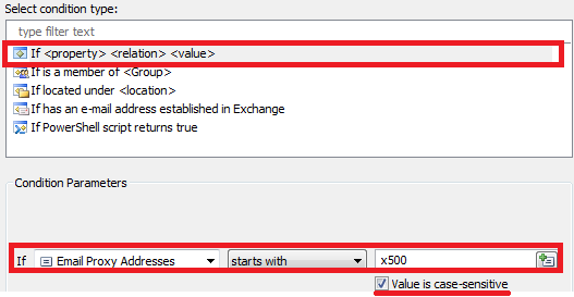

The issue is caused by DirSync. For some reason, it adds an X500 address to each user and contact during synchronization. Usually, Exchange requires for each type of proxy addresses to have a primary one, but the X500 addresses added by DirSync are not set as primary, which results in the error. To remedy the issue, we suggest creating a Scheduled Task that sets the X500 addresses added by DirSync as primary. We tested the solution in our environment, and there were no issues.
To create the Scheduled Task:
  3. On step 3 of the Create Scheduled Task wizard, select Contact Object type.

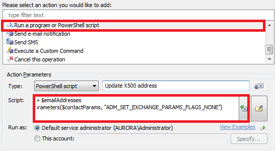

  4. Click Add Action and select Run a program or a PowerShell script.
  5. Paste the script below into the Script field.
     $contactParams = $Context.TargetObject.GetMailParameters()
     $emailAddresses = $contactParams.EmailAddresses
     $x500Addresses = $emailAddresses.GetAddressesByPrefix("x500")
     $x500Addresses[0].IsPrimary = $True
     $contactParams.EmailAddresses = $emailAddresses
     $Context.TargetObject.SetMailParameters($contactParams, "ADM_SET_EXCHANGE_PARAMS_FLAGS_NONE")
  6. Enter a short description and click OK.
  7. Double-click Always and select If .
  8. Select If Email proxy addresses starts with x500.
  9. Select Value is case-sensitive and click OK.

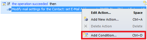

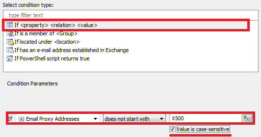

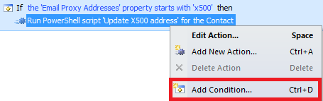

  10. Right-click the action you have created and click Add Condition in the context menu.
  11. Select If .
  12. Select If Email proxy addresses does not start with X500.
  13. Select Value is case-sensitive and click OK.
  14. Finish creating the Scheduled Task.
You should have the following Scheduled Task configuration:

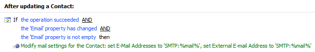

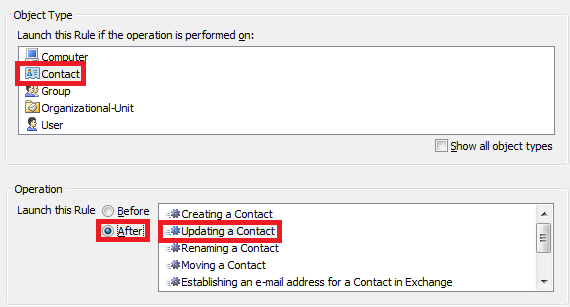

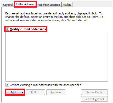

You need to create a Business Rule that will trigger After Updating a Contact. The rule will update the external address to match the AD email address if the latter has changed and is not empty. To create such a rule:
  3. On step 2 of the Create Business Rule wizard, select Contact Object type.
  4. Select After Updating a Contact and click Next.

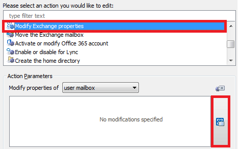

  5. Click Add Action.
  6. Select Modify Exchange properties and click Edit.

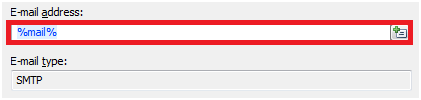

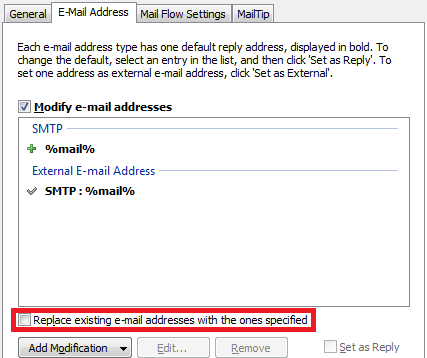

  7. Activate the E-Mail Address tab, select Modify e-mail addresses and click Add.
  8. Enter %mail% into the E-mail address field and click OK .
  9. Uncheck Replace existing e-mail addresses with the ones specifies and click OK twice.

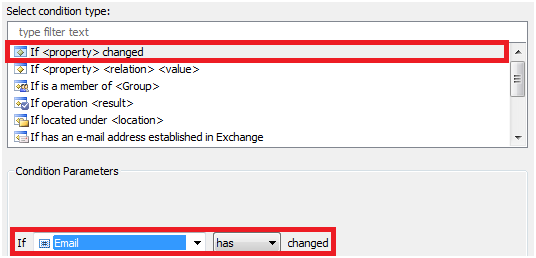

  10. Right-click the action you have created and click Add Condition.
  11. Select If changed.
  12. Select If Email has changed and click OK.

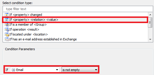

  13. Right-click the action you have created and click Add Condition again.
  14. Select If .
  15. Select If Email is not empty and click OK.
  16. Finish creating the Business Rule.
You should have something like the following:
